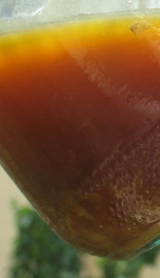

When I bought shellac, they had two types: a blonde one, dewaxed, expensive.  I've got good results with this one.  When prepared it is was clear.
I also bought a cheaper, darker type, supposed to be more natural.   I recently dissolved  a batch in alcohol because the other one ran out, and this one looks like muddy brown water.   Is this normal ?   I kind of needed to apply a seal coat to the guitar I just finished this morning.

It is already 4 days old now, and there is a lot of undissolved stuff floating in there.   I'll try to filter it, and will probably try to find time and go buy the nicer dewaxed stuff.

Can the stuff be poured off the settled wax into another bottle and stored for a limited time? (a few project and the rest for sealing)

Use a funnel and a cofee filter or just some cheese cloth and pour it through that. You'll probably end up with useable shellac that way.
